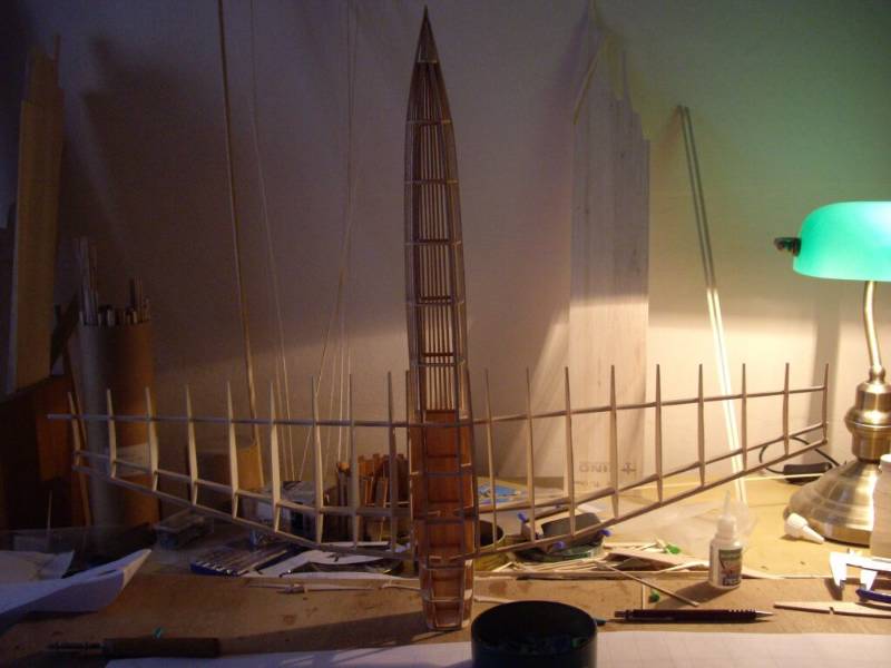

Ilyushin IL-2 type 3 version was used for the model.
Model is of classical balsa design, covered by paper. Used material was selected with respect to weight and strength. During the building I tried to spare every gramm. Weight was the factor in selecting the components for the model, given in the table below:
| Receiver: | Rex 5 MPD | 9g |
| 3x servo: | no.8524 19,6x8x19,6 mm | 4,3g |
| Battery: | lipo 300mAh/ 7,4V | 20g |
| Motor: | dualsky xm2812rtr-27/ 70W | 26g |
Final weight is 190g. Model is very stable with enough power. It glides nicely when motor is off. I tried stronger and heavier battery 450mAh/7,4 g (30g), that leads to slightly increased power and motor flight time duration, however that does not pay off 10 g weight increase.
The aim was to get slow and nicely flying aircraft in 1/20 scale. The plan is made so the building is as simple as it could. I hope that it can be an inspiration for those who like the original plan.
