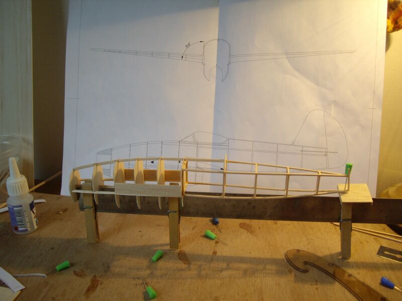

Fuselage:
The first step is preparation of two trussed sides, glued directly on the plan covered with plastic foil. Torso of the fuselage is then made of the sides and cross bars. Then we add G former and halfformers H, I, J and K (all formers are carefully cut from 0.8mm balsa covered by paper). Put the keels pos. 1 and 2 into the formers, add formers B, C, D, E and F and further add keels pos.3. Do not glue yet ! The fuselage is designed so it can be put onto steel ruler and check the alignment. Add reinforcements pos. 4 and When everything is in place and checked, glue it all together with diluted glue. Stringers are cut from 1mm balsa and after gluing to fuselage sanded to 0.8mm. Motor section is is made of cut paper tube prepared on 18 mm dowel. Intake and outtake are made of light balsa. Finally I prepared transitions pos. 5. The first window on lower part of the fuselage behind the motor output should be filled with light balsa. Elevator and rudder is made of balsa sheet 0.8mm. Canopy is made from Durofol 0.2mm on balsa last.

Is made of two halfs. Prepared parts are assembled without gluing in pin template on the plane. Then glued together with diluted glue.
