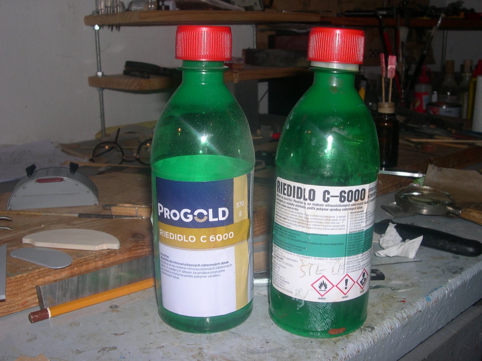

C 6000 na foto je OK-bez problemov. toluen-50-70%, metylacetat10-15%, butylacetat3-7% butanol10-12% etylacetat3-7% etanol 5-11%. Výroba- ELASTIK- Selpice.
